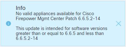

I tried to install the Cisco_Firepower_Mgmt_Center_Patch-6.6.5.2-14.sh.REL.tar
but I got the error mesage (see attched):
Info
No valid appliances available for Cisco Firepower Mgmt Center Patch 6.6.5.2-14
This update is intended for software versions greater than or equal to 6.6.5 and less than 6.6.5.2-14

The Hotfix DE, also known as 6.6.5.2 patch, can only be installed on 6.6.5 or 6.6.5.1. So, in your case, you must upgrade first and then patch.
