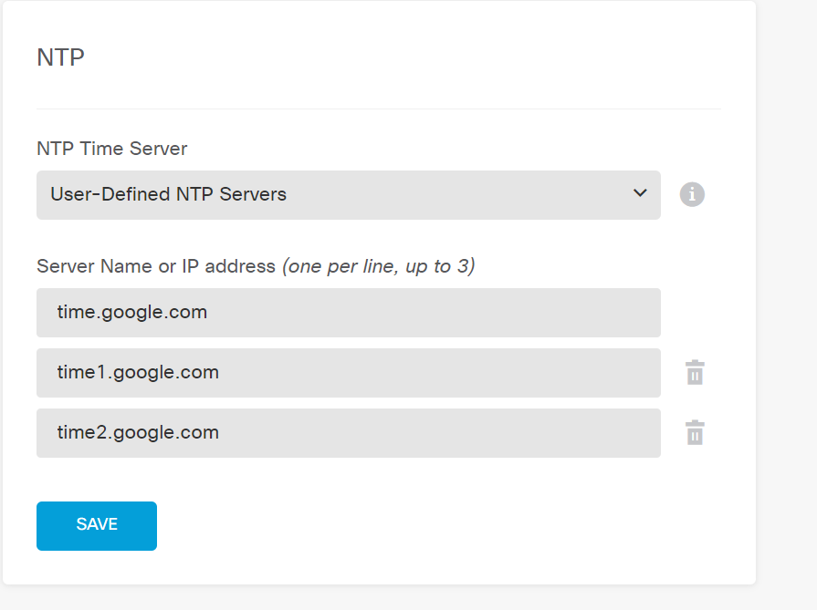

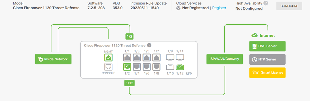

I'm setting up my Firepower 1120 and its running FTD 7.2.5. When I go to put in the NTP server I used google as a test the time wouldn't update I can ping time.google.com and when i show ntp I think it just gives me the local when I thought I had set up the servers. I'm stuck thanks for the helpNTP.png

Try adding IP address of time.google.com and test it

Does your management interface have DNS working and is it able to reach the specified servers?
Test with "ping system time.google.com" from the cli.
yes i was able to ping from the cli
check DNS configuration - make sure uses the right interface :
https://www.cisco.com/c/en/us/td/docs/security/firepower/630/fdm/fptd-fdm-config-guide-630/fptd-fdm-system.html#id_73499
BB
Thank you the ips worked
