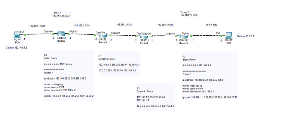

Hi Guys,
i have some issue with GRE Tunnel in Packet Tracer during my Training.. all the setup is correct, both tunnel is up/up, but i dk why it just cannot go like 192.168.1.2 -> 192.168.25.2 -> 10.0.0.2

@Thomas Leong
You've got the wrong tunnel destinations configured. The tunnel would be between the R0 and R3 outside interfaces, not the inside interfaces. Change to the following:-
R0
Tunnel1
tunnel destination 192.168.4.2
R3
Tunnel1
tunnel destination 192.168.2.1

Hi @Thomas Leong
Do you have the routing (dynamic or static) configured so each endpoint PC knows how to reach the other? Do the PCs have a default gateway setup for the local router's IP address?

Hi Rob Ingram,
Thanks for your correction, but the tunnel still not working, not sure why....

Thomas Leong
Hi Rob,
i think there some bug on packet tracer causing gre tunnel not working. because i try to rebuild gre tunnel it works. =.=
