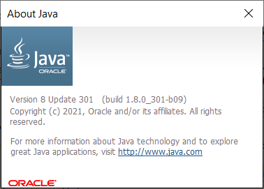

The Problem I am running into, if I go to: https://192.168.1.1 and install the ASDM Launcer (Cisco ASDM 7.1(3)) - It installs however I never see the program shortcut to run it.
If I navigate to the install folder, I can run it however:
I also cannot get the Java Web Start to work, and I installed the latest Java:
PC is running Windows 10. Any help would be appreciated.

Milos_Jovanovic
Hi @dsm600rr,
You are running latest Java, which disables TLS v1.0 and v1.1. On the other hand, your ASA5520 can run only TLS v1.0.
Please see this post.
BR,
Milos
