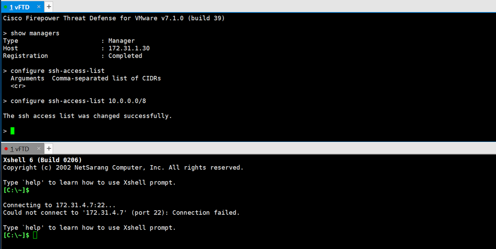

I tested it on my device and it appears to work as expected (prevented me from accessing the device from a non-10.0.0.0/8 address):

 I tested on my system it worked as I described. See my output below:
> configure ssh-access-list 10.0.0.0/8
The ssh access list was changed successfully.
> show ssh-access-list
ACCEPT     tcp  --  10.0.0.0/8           anywhere             state NEW tcp dpt:ssh
> configure ssh-access-list 10.0.0.0/8,172.16.0.0/12
ACCEPT     tcp  --  172.16.0.0/12        anywhere             state NEW tcp dpt:ssh
> configure ssh-access-list 172.16.0.0/12
