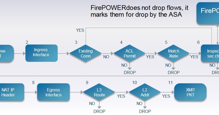

A Firepower service module (or, by extension, FMC) doesn't monitor ASA interfaces per se. It monitors traffic sent to is by the ASA class-map which is referenced in a policy-map and applied via a service policy (usually global). The class-map can say monitor all traffic or only traffic that matches an ACL. Whatever it scoops up is sent to the service module - irrespective of ASA interfaces.
Perhaps this flowchart will help explain it:
