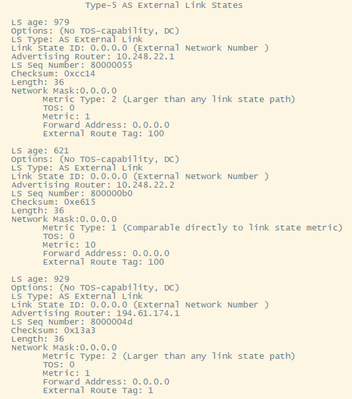

Can you share
Show ip ospf database external

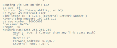

This is the output from the FTD - No luck
If 1.1.1.1 is appear  then that good'
The routing bit set is missing from defualt route' which make route appear in ospf db and missing from rib.
