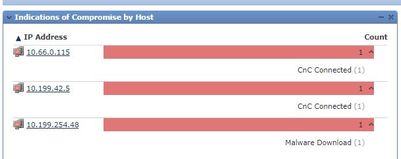

We are running FMC 7.2 and on the summery dashboard on the Threats TAB, there is a list called  "Indication of Compromise by Host" where we can see hosts that have downloaded malware and are CnC connected. It looks like this:
We would like to get an email or/and a SNMP alert whenever this happens, but I cannot find where I can configure this.

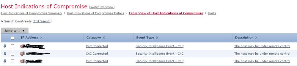

Did some more invistagation into this and the IoC events we see in the Threat TAB in the dashboard comes from the Analysis->Hosts->Indications of Compromise page.  Is it possible to get emaill alerts for those events?
Thanks
