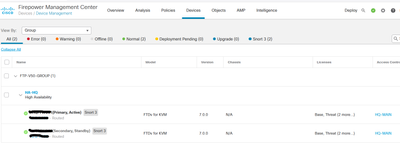

I've added more subinterfaces over the FTD and set policy  [ ANY >> ANY ], but the connection between these subnets is down.
FMC version : 7.0.0
Find the attached files to check the Configuration
