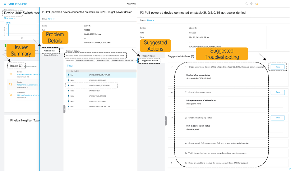

Cisco DNA-Center Assurance identifies the issues and provides detailed trouble-shooting steps for easy resolution. Maintaining logs showing problem detail, DNA-C Assurance helps identify whether the device is faulty, if the switchport has shutdown, or if the device is asking for more power than it has negotiated in the beginning. It provides suggested troubleshooting actions where the commands can be run directly via Cisco DNA Center. If the issue remains unresolved which is highly unlikely, a TAC case can also be initiated with just a single click.
