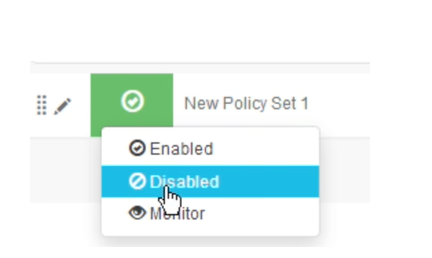

  1. Use one of the three ways shown above and add a new Policy Set.
  2. As a good practice, change the status to [ Disabled ], as this policy set is incomplete.

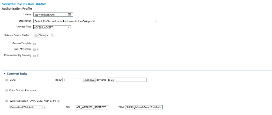

Authorization Profile for Wired Web Auth
  1. In ISE, click Authorization Profiles from the left-hand pane under Policy > Policy Elements >  Results > Authorization.
  2. Locate the Authorization Profile Cisco_WebAuth. Select it and Duplicate.
  3. In the edit page, update the name to sdaWiredWebAuth. Then, scroll down to the section Common Tasks, first locate VLAN and put Guest into the text box next to ID/Name. Then, locate Web Redirection (CWA, MDM, NSP, CPP), enable Static IP/Host name/FQDN, and put the ISE IP Address into the text input box, as shown below.    Picture14.pngPicture15.png
Static ip is needed only in case of Lab Environment where there is no DNS setup, we can use ISE IP address for redirection
  1. Scroll to the bottom and click [ Submit ] to apply the changes.

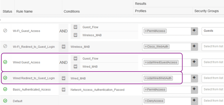

Policy Rules for Wired Guest Auth and Access
  1. Navigate to Policy > Policy Sets. Then, click on > at the right end of the Default policy set to view the details.
  2. Expand on the Authorization Policy section and scroll all the way down. Insert two rules before the one on Basic_Authenticated_Access as shown below and then Save.    Picture16.png

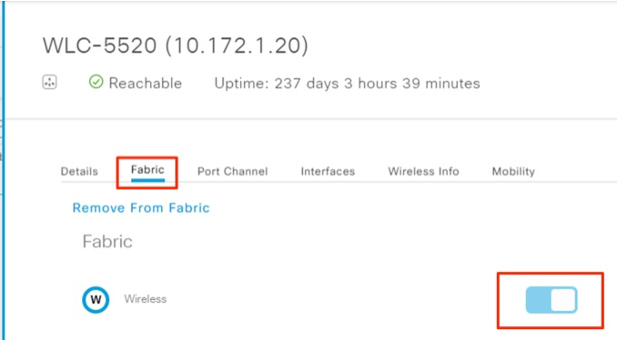

Add WLC to Fabric
This step is needed only if we did not provision WLC before.
  1. Access Cisco DNA Center web UI
  2. Go to PROVISION > Fabric
  3. Select the main site from left panel.
  4. Under Fabric Infrastructure, select WLC-5520
