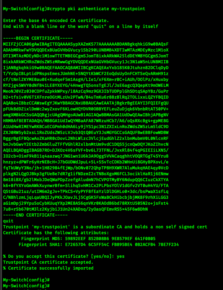

Typically in a PKI there is one Root CA and multiple Subordinate or Issuing CAs.  For this purpose, we need to authenticate using the Subordinate or Issuing CA's cert.  We need to install the Authenticating CA certificate first so later when we install the Identity certificate the device can validate the Identity Cert.
configure terminal
  crypto pki authenticate my-trustpoint
Here is an example of a Certificate Chain. Here we see the Root CA, the Subordinate or Issuing CA, and the Device or Host Certificate.  The Root CA only issues certificates to its Subordinates.   It's the Issuing CA that gives certificates to the devices. Subordinate CAs can issue tens of thousands of certificates to end hosts. In the above screenshot we just installed the Subordinate CA Certificate.
