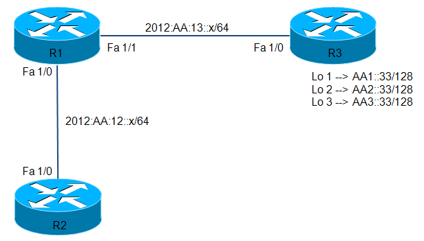

    In this document, three routers (R1,R2 and R3) are configured with OSPFv3 routing protocol, with router R1 and R3 in Area 0 and R1/R2 in Area 12. Router R3, has three Loopback interfaces and are advertised via OSPFv3. The only exception of Loopback 3, which is redistributed into OSPFv3 routing protocol to make it as an external route. This is done purposely to differentiate between different type of routes received by router R2 under different cisrcumstances. Under Normal conditions, i.e. running OSPFv3 without any of the stub feature all these routes will appear at R2 as below.
    Note: route OE2 is external as it was redistributed on R3 as a connected route. See configuration of R3.

    Topology Diagram
