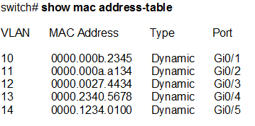

The switch builds a MAC address table comprised of MAC address, switch port and VLAN membership for each connected host. The switch creates a separate MAC address table for each configured VLAN. Any unicast flooding of a frame to learn a MAC address is for the assigned VLAN only. The following IOS show command will list the contents of the MAC address table for a switch. Where there are multiple VLANs configured, the switch will list all MAC address tables for all VLANs in a single table listing.
