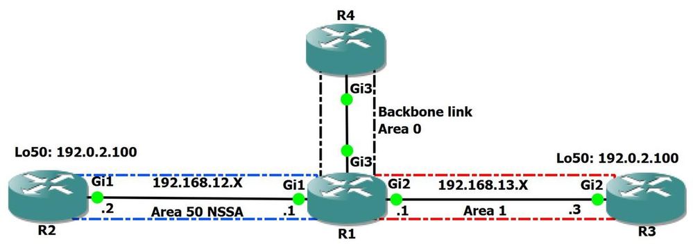

Refer to the network diagram in Figure 1 as you use this document:
In the network diagram, there is both a non-backbone area 1 and a NSSA area 50 connected to R1. R1 is an Area Border Router (ABR) connected to backbone area 0. Both R2 and R3 are responsible for redistributing the same prefix 192.0.2.100/32 into the OSPF domain.

Scenario 1
Network Diagram
In this scenario, we will be looking at what behaviour is observed when using RFC 3101 for external path calculation. We will be interested in prefix 192.0.2.100/32 that is redistributed on both R3 and R2.
 Type-1 LSA from R1 is in the below output:

Now lets check what LSA is preferred on R1:
R1#show ip ospf rib 192.0.2.100
            OSPF Router with ID (1.1.1.1) (Process ID 1)
                Base Topology (MTID 0)
OSPF local RIB
Codes: * - Best, > - Installed in global RIB
LSA: type/LSID/originator
*>  192.0.2.100/32, NSSA2, cost 20, fwd cost 1, tag 0, area 50
     SPF Instance 38, age 00:04:51
      contributing LSA: 7/192.0.2.100/2.2.2.2 (area 50)
      contributing LSA: 5/192.0.2.100/3.3.3.3
     Flags: RIB, HiPrio, ViaFwAddr, IntraNonBB, NSSA P-bit
      via 192.168.12.2, GigabitEthernet1 label 1048578
       Flags: RIB
 As we can see in the above output, R1 prefers LSAs Type-7 from R2. This is because we are following RFC 3101, which has the following path calculation preference
1. A Type-7 LSA with the P-bit set.
2. A Type-5 LSA.
3. The LSA with the higher router ID.
Note: Please be aware that the following path calculation preference is applicable if the current LSA is functionally the same as an installed LSA. We can verify that the forwarding metric for both LSAs are the same looking at Type-1 LSA of R1.
Since the Type-7 LSA was recieved with P-bit set we will prefer this LSA over other Type-5 LSAs.
Now if we clear the P-bit on NSSA Type-7 LSA from R2 we will see that we will prefer Type-5 LSA from R3.

 Now when we check on R1 we see that we prefer Type-5 over Type-7 LSA.
OSPF local RIB
*>  192.0.2.100/32, Ext2, cost 20, fwd cost 1, tag 0
     SPF Instance 39, age 00:03:32
     Flags: RIB, HiPrio, IntraNonBB
      via 192.168.13.3, GigabitEthernet2 label 1048578
       Flags: RIB
OSPF local RIB
     SPF Instance 44, age 00:01:56
     Flags: RIB, HiPrio, IntraNonBB, PartialSPF
       Flags: RIB
 Note: In the above output, you might have also noticed that R1 is not translating Type-7 to Type-5, this is because only Type-7 routes that have been added to the routing table may be candidates for translation.

asofrani
Hello @aung-thura,
I believe the above statement you are referencing from RFC 3101 helps us determine which LSA type is preferred. Once we have determined this we may, of course, perform ECMP. Since you have two type 7 LSAs they are both added into the OSPF RIB and FIB.
I hope the above helps.
Kind regards
Aleksandar Sofranic

gongya001
Level 5
Level 5
Can you post the diagrams ?
thanks !!
asofrani
@gongya001, I have updated the document with the network diagrams. 🙂
gongya001
Level 5
Level 5
thanks so much !!
