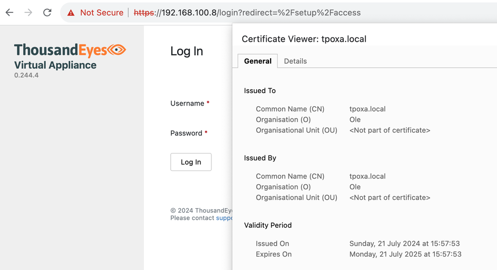

  • SSL certificate before changes: issued on 21 July 24, valid till 21 July 2025:

As we can see, the main files here are the .key and .cert files. If we check their creation dates, we will see that they exactly match what is displayed in the web browser when we connect to the device and under Appliance UI – SSL Settings.

Let’s open a new browser session and access Appliance (https://192.168.100.8):
We can see the certificate is re-issued with new parameters, including dates, CN, and Organization!
