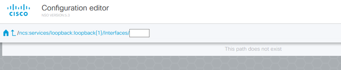

Dears,
used NSO ==> 5.3
i have created a simple python action that lists the interfaces of the device based on the type u choose as shown below
, but when i click run it redirects me to the below page so i need to refresh page to see the outputp1.PNG
python Action:
yang:
how can i solve this to present the output within same page without reload it.
Thanks in advance!

Thanks @aelganzo
i was just trying to implement some actions using python for other cases, but i got same issue "need to refresh the page".
BTW i tried same action with another NSO version, and it works properly now.
Thanks a lot for your response.
