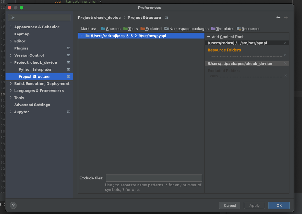

Hi @Siliano ,
I don't know if it works in the Community Edition but here is how it can be done in the Pro version.
In your project go to "Preferences" => "Project [Something]" => "Project Structure", click on "Add Content Root".
Point to the path of a NSO local install on your computer , the api is in "src/ncs/pyapi" of the local installScreenshot 2022-02-09 at 15.18.09.png

Hi @Siliano ,
