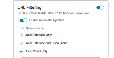

Currently I have this issue to connect to this services. All license have being applied in the FMC (SCW-FMC1). but this error are bugging me. I try to update the URL filtering, also failed. I also have setup similar FMC (TCW-FMC1), but no error similar like this one.
All version model, all configuration are same. I try suggested solution where i need to use pmtool restartbyid beaker3, and talosAgent... it also not solve the issue cause, it said it will trigger back after 5 days, right? but this I try, and it came back in same day.
I need this issue solved, before I plan for migration old firewall to new firewall... Troubleshooting process i have done, is I try access expert in cli, then telnet to all known url to get an update to url filtering and else. Can successful telnet. I also can register smart license. So hardly this is problem with connection to the internet. All the config inside of the FMC, have basic configurations.
Please let me know, how to fix this. thanks

Suddenly, it solve it self... lol
can update, and no more issue related to the talosAgent and beaker3....
