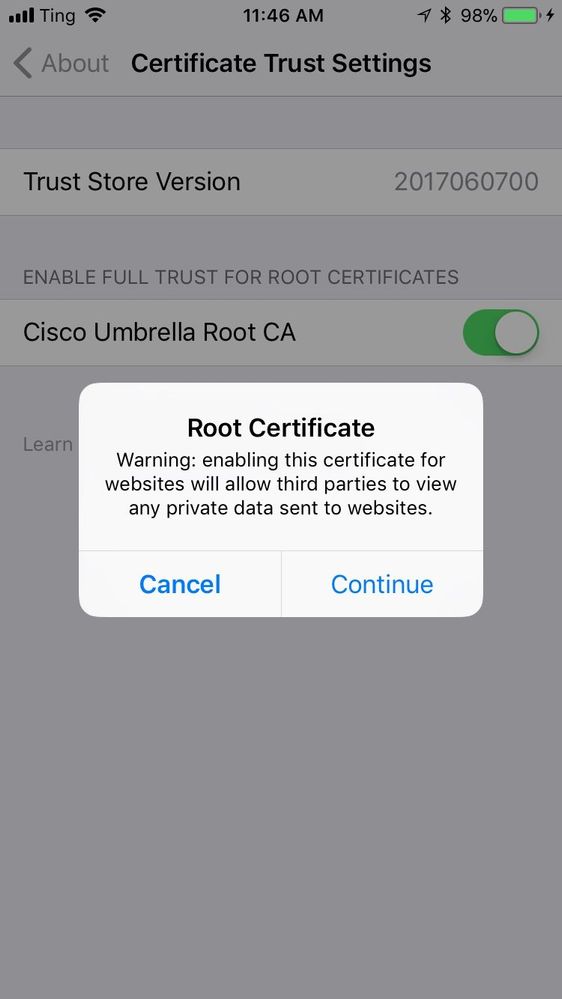

There is another setting in iOS under Settings>General>Certificate Trust Settings: Enable Full Trust For Root Certificates
The Cisco Umbrella Root CA is listed here with a slider to enable or not. Should we enable?

"Is this posted on the site somewhere or is it from your copy of the CA?"
This is from the certificate itself.
"Can you explain what all of these warning messages mean?"
You may want to raise a support ticket with OpenDNS if you are concerned.  We other users can hardly help you further.  We are generally in the same situation like you as user.
