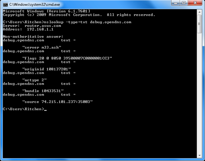

You have to flush the caches on all computers where you have visited League of Legends before, else you will still be served out of your caches, not necessarily with actual DNS data or content, until the caches expire.
If you're still having problems, copy & paste the complete plain text output of the following commands to here:
nslookup -type=txt debug.opendns.com.
nslookup whoami.akamai.net.
nslookup leagueoflegends.com.
nslookup na.leagueoflegends.com.
nslookup play.na.leagueoflegends.com.
hcco
rotblitz
Level 6
Level 6
Plain text looks differently... :(
Point 1 was incorrectly answered.  You are not using OpenDNS, but clearly Google Public DNS (8.8.8.8)!  Google does not care about your OpenDNS dashboard settings.  Why did you say that you're using OpenDNS?
Correct this, and try again.

hcco
Done
hcco
rotblitz
Level 6
Level 6
Brilliant, this looks fine now!  (Although it is still not plain text.)
