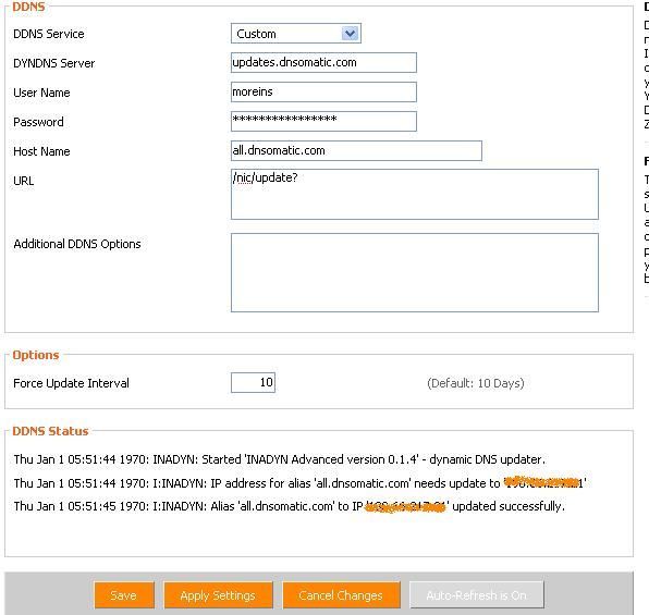

ingber
P.S. I seem to have go this working OK, using info on http://www.dd-wrt.com/wiki/index.php/OpenDNS and http://www.dd-wrt.com/phpBB2/viewtopic.php?p=273200#273200 .
I have two networks in my account, and one of them requires updating from time to time.  I have the most current stable dd-wrt on my router, and it seems that only "Custom" qualifies for OpenDNS updating, as OpenDNS or DNS-o-Matic does not appear.  (I have a free dyndns account, but apparently that is not useful.) See attached for that screenshot of Custom. How would I fill in this form, using one of my two OpenDNS networks?support.opendns.com_hc_user_images_qWuiKFcliC-nq8IpE2kpcg.jpeg
rotblitz
Level 6
Level 6
What is the problem following the instructions from the links you posted?
There is also a clear picture at http://www.dd-wrt.com/wiki/index.php/OpenDNS
