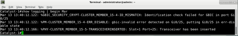

On the Catalyst switch though I see some error:
It seems that for some reason the Catalyst does not like the cable ?
Please help me resolve this issue.

Looks like you have 3rd party SFP on Cat 2960 side:
Catalyst switches can have problems with third party SFP's so it may be worth doing the following to make the SFP work:
no errdisable detect cause gbic-invalid
service unsupported-transceiver
BB

According to the data sheet, the 2960L-24TS-LL does not support 10G. This is probably your problem. The WS-C2960L-24TQ-LL model does.
See link below:
https://www.cisco.com/c/en/us/products/collateral/switches/catalyst-2960-l-series-switches/data_sheet-c78-737665.html
Hope this clarifies things.
