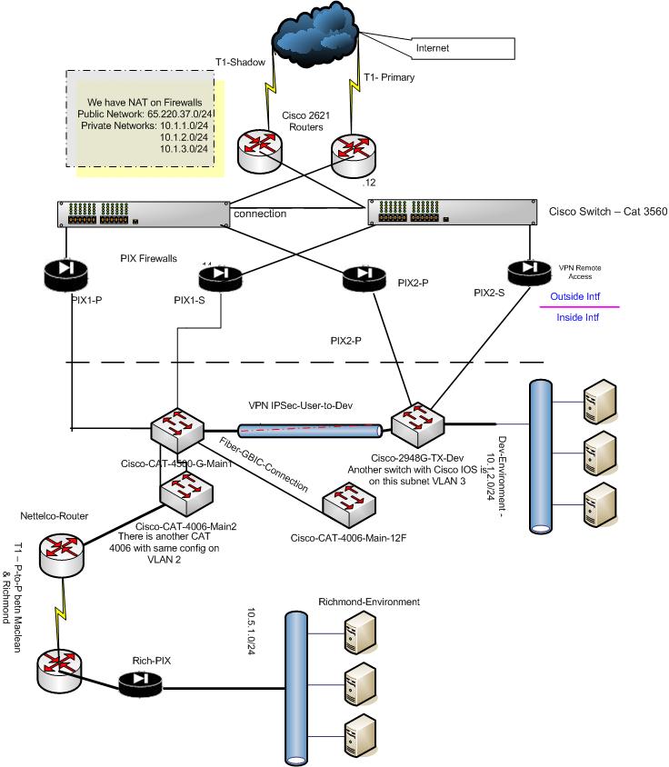

I have also attached a Viso diagram, it may help.
I beleive the Gw-Nettelco router is the one for routing between VLANS, your thoughts??????

here it is in a JPEG format. sorry man.
pls let me know if you have any questions.

I am looking at your diagram and see no connections between the CAT 3550s you have listed in the center of the dig connected to other, i beleive CAT 3550s or 3560s and the connection is shown in Green.
no connection between these switches and the rst of the network. Also, how VLAN 4 is connected to VLAN 2 and I don't see where VLAN 3 fits?
Also, I don't see any routers? are U using the L3 capabiities of the switches for routing between VLANs?
where is the edge of the network comparing your diag with that of mine?

I have provided a Diag of my network topology.
