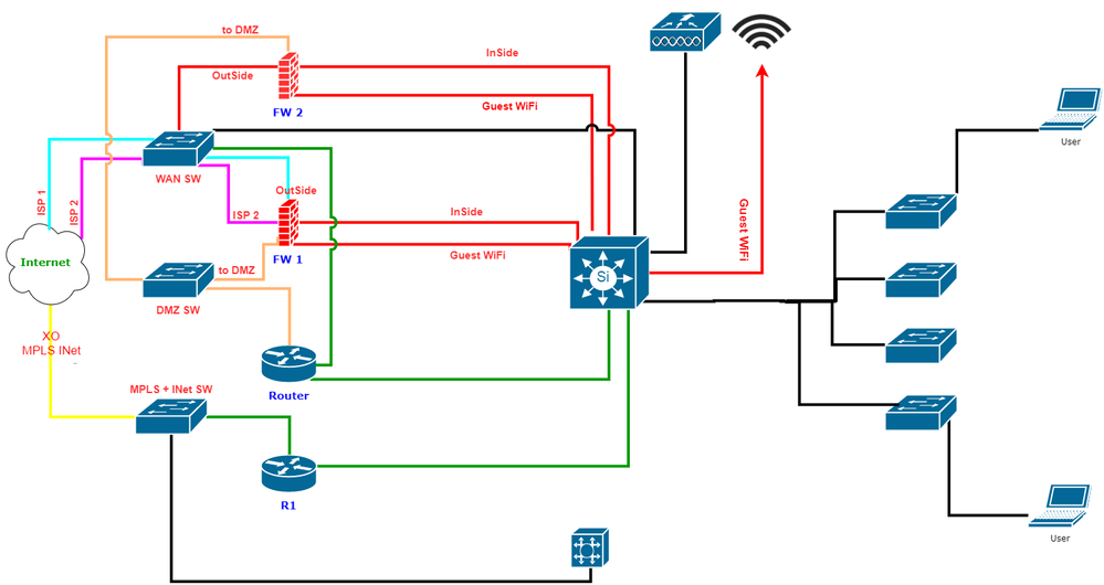

02-17-2018 12:05 AM
My case is little different ... please refer the diagram
My AP is getting EIGRP routes injected for two gateways (Guest interfaces on two firewalls) to public internet for Guest SSID
AP is authenticating the clients but not issuing ip address i.e. DHCP lease to Guest SSID clients
There are other SSIDs on the AP which are working fine except Guest
When i shutdown the Guest WiFi interface on either firewall ... Guest SSID starts working fine
Any suggestion would be greatly appreciated
