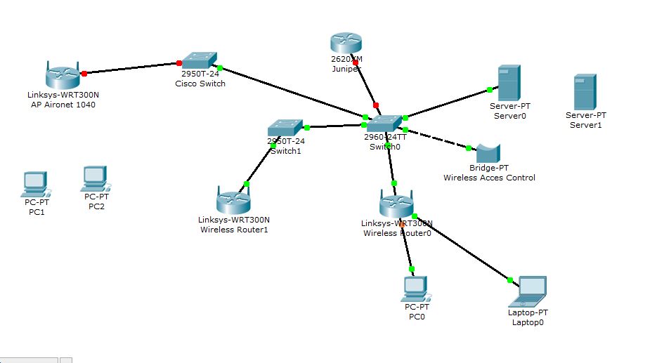

First I give info to my enviroment network.
Server PT Server0 = this is DHCP server
Switch0 = main switch with 6 vlan.
vlan 110 - Reserve
vlan 111 - Equipment network
vlan 112 - Server
Vlan 113 - printer
Vlan 114 - Main-Staff
Vlan 115 - Guest
Vlan 116 - Editorial
Switch1 = Editorial with 6 vlan.
vlan 110 - Reserve
vlan 112 - Server
Vlan 113 - printer
Vlan 115 - Guest
Cisco Switch = Bookcafe switch with 6 vlan.
vlan 110 - Reserve
vlan 112 - Server
Vlan 113 - printer
Vlan 115 - Guest
AP Cisco AiroNet 1040 in Cisco Switch
This configuration In AP

In configuration...
Will i connect to Guest (VLAN115) DHCP working. but Will i connect to VLAN 114 and VLAN 116 DHCP not working. So how to doit..?

09-27-2013 12:14 AM
Hii this client use AP. but IN AP I configure virtual Port
Dot11Radio1.114 (for VLAN 114)
Dot11Radio1.115 (for VLAN 115)
Dot11Radio1.116 (for VLAN 116)
AP conect to PORT in switch Catalyst 2960-C Series.
This Switchport configuration

AP connect to Interface Fa0/2. not Fa0/1
