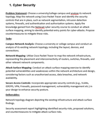

Do u have the solution for one more pic which i have attached?
Sorry which one?
This is the problem statement. I have tried completing it till task 2.
Task 3 and Task 4 i am not getting any idea how to do it.
WoW good task
but sorry this cant be done in Packet tracer
Agree with you!
Best regards
Okayyy.... Then how to do it?
