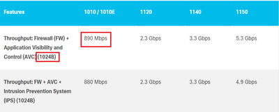

M02@rt37  is correct it is packet size
check this screen
890 Mbps is throughput
there is not we can called relation but when cisco engineer test throughput for these series, they must fix some detail like packet size, l4 protocol use and etc.
then they measure the throughput with add some feature like SI.

Here If 1024B is packet size then 890Mbs is what? I can't understand the relation between them. If we can explain this it will be helpful for me.
MHM
