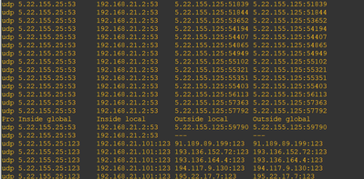

Can you share the config of RC router into a text file?
Can you do a show ip nat translation on R1?

Here we see nat translations.
