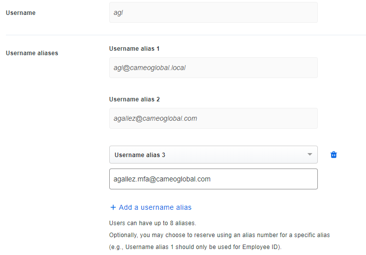

Config of the Duo user
As you may see here, I added an alias matching the SF username but still, it does not work.

So your username and aliases in the Duo Admin Panel only impact what usernames we recognize when doing things like Duo 2FA. The value that is being sent to Salesforce is the attribute that in your Authentication Source
If you go to your Salesforce application in the Duo Admin Panel under the “Service Providers” section you should see a checkbox next to Custom attributes. Here you can specify a different authentication source attribute to send to Salesforce when authentication. By default we use mail for Active Directory and Emailfor SAML IdPs.
If you have an attribute in your authentication source that matches your different logins you can specify it there per Salesforce application.
