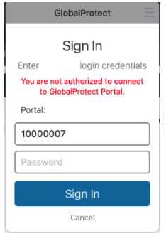

The issue is, that just after authentication my GP agent shows You are not authorized to connect to GlobalProtect Portal
