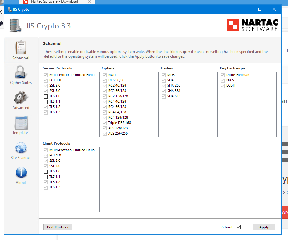

TLS 1.0 and 1.1 were enabled on the web server so I disabled those on both server and client - and rebooted. Duo still not prompting when I logon to the website. Does Duo only kick in for new accounts?

It was all regedits - about 4 of them. Dr. G got me the correct ones after about an hour of searching. If I remember correctly, disabling TLS 1.0 and 1.1 and forcing the server to use TLS 1.2. Maybe also forcing IIS to only use TLS 1.2. Just keep track of your regedit changes (backup the key) and test. Also, rebooting the server was mandatory in between changes. IISreset isn't enough..
