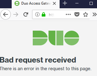

I got some problems with the initial setup of DAG.
The logging is not giving me anything to go on, at least I cant see it.
I have installed a fresh windows server 2016 standard. Followed the DUO guide to install DAG.
No errors or anything, so far so good.
But now when I launch my browser to continue I only get prompted with the error “Bad request received”.
Entry in my dag.log is the following:
May 02 08:27:29 simplesamlphp ERROR [b05873c03c] SimpleSAML_Error_BadRequest: BADREQUEST_HIDE_REASON(’%REASON%’ => ‘The Duo Access Gateway Launcher is not configured. Please create a Duo Access Gateway application in the Duo Admin Panel and configure it in the Launcher settings page of the Access Gateway Admin Console.’)|Backtrace:|0 C:\inetpub\wwwroot\dag\www\launcher.php:18 (N/A)
May 02 08:27:29 simplesamlphp ERROR [b05873c03c] Error report with id 6fdf72b5 generated.
Cant get past this, any help is welcomed!
Edit: Yes I have search the forums but did not find anything related to this.
Thank you!

Hi Patrik,
Please ensure you’re going to https://yourserver.example.com/dag, not just https://yourserver.example.com to reach the DAG Admin Console.
There is also the following shortcut available in Windows: Start Menu > Duo Access Gateway > Configure
Hi Dooley,
Ah yes now you reminded me about one thing that seems a bit confusing, lets see if I can explain this
When I browse for https://yourserver.example.com/ I get the above error page
When I browse for https://yourserver.example.com/dag/ I get a 404
The https://yourserver.example.com/ url redirects me to https://yourserver.example.com/dag/launcher.php
So actually the …/launcher.php gives me the error, and that might not be so strange. But then the questions is, how come I get a 404 on the main page.

Hi Patrik,
I chatted with some members of our Support Team about this, and they suggested the two following possible solutions:
  1. This could be related to your browser’s security settings. Please try accessing from a freshly updated version of Chrome or Firefox to see if it resolves your issue.
  2. If you’re running the DAG on an externally-hosted VM, please reference this knowledge base article: https://help.duo.com/s/article/3069 to resolve your 404 issue.
Patrik1
Ah, It is solved now.
Had my mind set on the first error.
The issue was in our network and that the DAG-server was reporting that is tried to access the webpage from an other ip (or gateway acctually).
Resolved it and now I can access the “set password” page.
Thanks!
