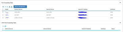

The port-forwarding rules configured on the router are as follow: (I'll upload again the configuration)
HUELLERO TCP/UDP 5010
LOREX OFICINA TCP/UDP 9000
WO RDP TCP/UDP 23419
These IP addresses are mapped with internal services of the company, hosts, biometrics and servers. These services, are exposed to internet (customer is aware of this). So, the problem that we are having is, after a certain amount of time (can be hours, days, minutes, weeks) configuration breaks. Meaning that even though the configuration remains (VPN Client-to-site and Port forwarding) we cannot access them. If I tried to access my router using OpenVPN during this breakdown, router will not let me in, so all my client's users will be disconnected from the router. Same goes for the Port-forward, we cannot access any service during this breakdown. Again, configurations are in place and the router is not being configured or modified. However, I can access the router from a browser.

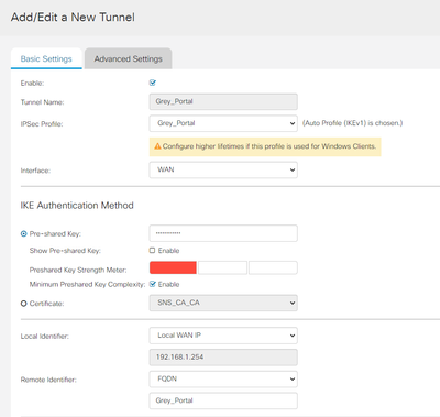

3. The screenshots posted by you show a Client-to-Site server config for a IPsec-VPN-Server....but you mention that you are using OpenVPN.
a) so if "OpenVPN" server is also enabled, please post the screenshots of its config pages

3. We have two types of VPNs Client-to site. We are using OpenVPN (SSL VPN) and SoftVPN (IPSec). I'm sending the configuration of the OpenVPN.
