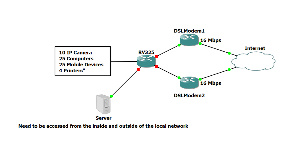

Do RV routers, for example, the RV325 supports CLI through the console port and/or SSH?
I'm thinking of using an RV325 router in a small network. Please check the picture below. What do you think of using an RV router for such network?
Thank you!
I'm asking about the CLI because I'm more familiar with it than the GUI.
Do these routers come with some sort of "port forwarding"? I want to make sure there is a way for me to connect a server to the integrated switch, not the WAN/DMZ port, and access it from inside and outside of the local network.

balaji.bandi
Most of the configuration can be done over GUI, you still like to have access to cli
follow the admin guide
https://www.cisco.com/c/dam/en/us/td/docs/routers/csbr/rv320/CLI_guide/rv32x_cli_guide.pdf
BB
Thank you!
Are the commands in this pdf are the only supported commands? There are no "switchport ...." commands in the pdf.
One more question please, will this router allow me to connect the two WAN links to 2 DSL modems for redundancy and load balancing, and connect a server to one of the integrated switch ports. The server should be connected from inside and outside of the local network.
these are SMB switches, most of the configuraiton can be done using GUI, so user not required to go in to command level.
Regarding your question, this model is dual WAN connection you can connect 2 WAN Links
here is guide for reference :
https://www.cisco.com/c/en/us/support/docs/smb/routers/cisco-rv-series-small-business-routers/smb4242-dual-wan-configuration-on-rv320-and-rv325-vpn-router-series.html
BB
Thank you!

RV support port-forwarding, worth looking product documentation also :
here is port-forwarding example :
https://www.cisco.com/c/en/us/support/docs/smb/routers/cisco-rv-series-small-business-routers/smb4159-port-forwarding-and-port-triggering-on-rv320-and-rv325-vpn-r.html
