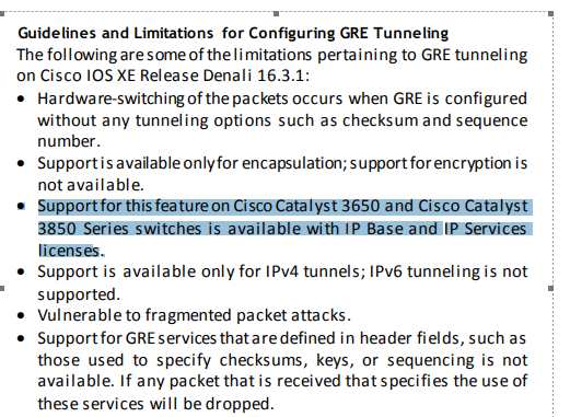

Actually L3 switch 3650 that I have it is an ipservices license which is not suppot Tunnel interface configuration.

The point is my L3 switch is not support Tunnel configuration because I have only Ipservices license.
