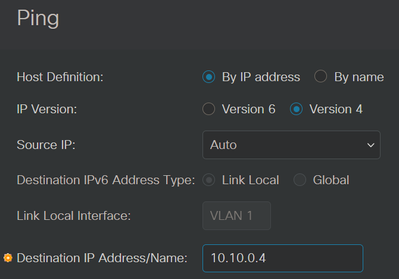

If CBS350 has no ARP Table entry for 10.10.0.4, then the ping A to B is failed. (not replied.)
  • From CBS350 Web (screen captured below), there is no ARP entry for 10.10.0.4
  • And Wireshark capturing in the same subnet shows no ARP packet is shown which is looking for 10.10.0.4
Now, I can do ping from CBS350 to 10.10.0.4 from the CBS350 Web.
Then the Dynamic ARP entry is added to the Table.
  • And at the same time, wireshark captures the ARP packet looking for 10.10.0.4 sent from the CBS350.
Then the ping A to B works!!!!  the reply from B is suddenly coming after the CBS350 ARP entry is added for the 10.10.0.4

    • Doing ping from CBS350 Web is work fine, filled up ARP table and also ping is done successfully.
      • CBS350 - 10.10.0.254  --> 10.10.0.4 - host B
      • if I delete the ARP table manually, it immediately re-fill the ARP table.
