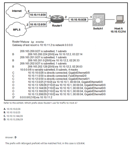

3/
In the picture, there is no
10.10.13.208/29
why are there differences between exhibit and CLI info? Something to do here with longest match? May I get a more precise explanation?

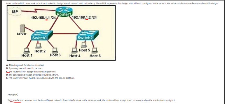

4/ Here I suppose both switches belong to the same network
162.168.1.0

3) Even though you see nothing for
1010.13.208/29
it is assumed that the switch is advertising that
prefix
over ospf with a
next hop of its 10.10.10.1
interface
4) Correct the router cannot have two interfaces in the same routing table associated with the same subnet
192.180.1.0/24

Concerning /4
a minor portion of the explanation is missing, preventing me from getting the full picture. Fortunately, I eventually got both switches belong to
162.168.1.0

 Do you have any trouble understanding the question 4 ?
No, I got it, the problem is there is no demonstration. I would have formulated the answer in a clearer way.
1010.13.208/29
prefix
over ospf with a
interface
192.180.1.0/24
