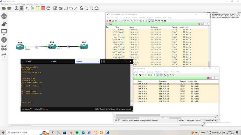

ive just been looking at EIGRP stub's.  I thought I'd break it down to a simple topology to confirm what i was seeing.  So theres a loopback address on router 1 which i've shut down, from router 2 you can see that router 3 is a stub and supressing queries but on the debug on r3 im seeing a query message ?

Thats the eigrp config on router 3
I run same lab
and as you can see only hello there is no quires.
are you sure you add receive-only <<-
Yup just double checked it, also removed receive only so its only using the default connected and summary...weird i wonder if its the router image - i might try another one.  I thought maybe it was the debug i was using - debug eigrp packet query -

Just to confirm, if R3 is the only configured as a stub then you shouldn’t see any query, however you should see a update depending on the debug you are running.
debug eigrp packets query
( only set to see capture query’s)
