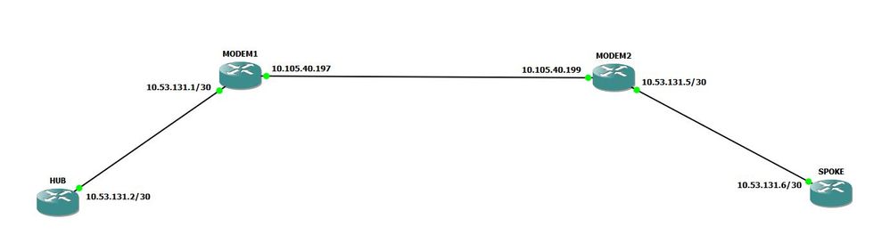

I am trying to configure DMVPN connection between two routers (and more programmed), following this diagram:

First of all, i changed my tests from DMVPN to SITE TO SITE vpn, just temporary to check if my 3g modems have the necessary ports open or not.
What i did, is simulating the same topology with the same IP addresses, as the following screenshot, and tried to create a site to site vpn (back to the basics).
In that case, the tunnel is created correctly, and everything can reach everything. I configured my routers, with the same configuration as the simulation, and worked properly. (Now time to come back to the first objective which is configuring DMVPN).
Please, attached, is my configuration (new DMVPN), of the hub and spoke, and the two modems (routers for simulation, nothing special about them, and no problem in their configurations just configuring NAT for test).

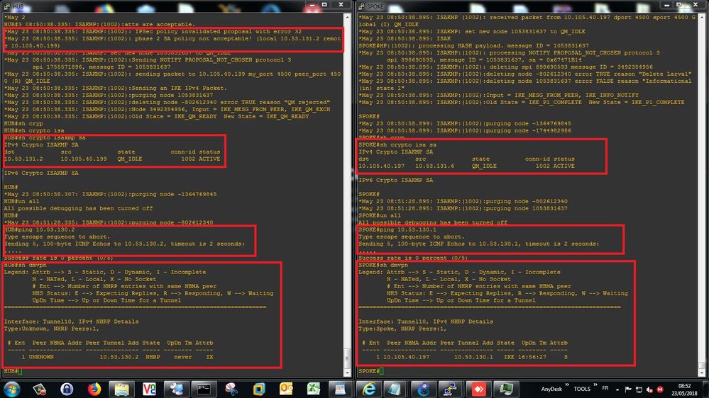

When i read debug traces, i find that the tunnel is not created and blocks in phase 2 (as the bellow screenshot). Can you please help me in this final step?

Thank you for your reply.
I changed the tunnel mode in the transform-set, to Transport. What i notice, the tunnel state is IKE, and the tunnel is up. I noticed that the command show dmvpn in the HUB, displays UNKNOWN.
And the ping from both hub and spoke to the other tunnel ip address does not succeed.
Thank you in advance.
I had labbed this scenario and replicated your initial issue, changing to transport mode got the VPN to work. Did you shut the tunnel on the spoke and clear the sessions?
I would like to thank you so much for your help. It is now working correctly between HUB and SPOKE. I even added a new SPOKE to check if it does work, and it did.
