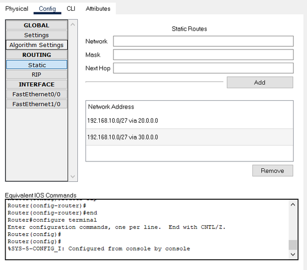

I was given a task withing cisco packet tracer to set up a DHCP configuration, connect the routers with static routes and assign specific subnet masks. I had the most problems with dhcp and static routes. this is how the connected network looks like:

router 1: 10.0.0.1 , router 2 : 20.0.0.1 , router 3 : 30.0.0.1
and then attempted to connected them using the static route menu: 
and made similar routes on each router. I though this would allow me to send messages in-between computers in different dhcp networks but it does not. I though I followed the tutorials and guides on youtube and such correctly but I guess I am still missing something. I am thinking it might be something to do with the switch in the middle but i am not sure. any help would be greatly appreciated!
