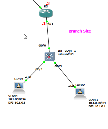

I ahve some Guest Docker Ubuntu containers, they can connect to the topology but I want to add static routes. How can i add a static route to it?

I have another question would anyone have a suggestion to add a static route from this layer 2 D2 switch to reach 10.1.0.1  R3   f0/1 interface
Only thing I have defined on it is a management VLAN, and I can't point static route out the access port
2#sh run

Ip routing need for static route
If you want to keep it as l2 sw
Then defualt gateway will be only need.
hfakoor222
I crashed my computer earlier and it did something when it autosaved the GNS topology to where the access port behavior wouldn't ping to the router.
