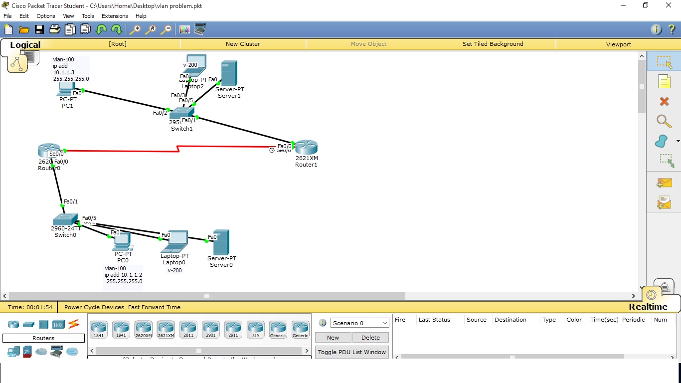

how to connect vlan on the other side
abdulrahmanm18
the problem is pc0 cant comunicate to pc 1
im using ospf on both routers
both pc on same vlan and subnet what should i do?
i feel i have to use diffrent ip for the remote pc?

Hi abdul,
your configuration looks incorrect, you have an ip configured to the physical interface fa0/0 on both the routers as well as you have the sub interfaces configured..remove the physical interface ip's and just configure the sub-interfaces with the ip address on both the routers.. have the sub-interfaces configured with 2 different network segments on both the routers and the the switch end interfaces which are connected to the router as "switchport mode trunk".. once done then have the pc's allocated to the respective network segments which are part of that sub-interface ip's ...
Ensure that all the networks are advertised over ospf and verify the ospf neighbor ship between router and also check the ospf routing table ..
Try to ping the hosts which are in different lan segments which should be successful.
Ganesh Hariharan
You need to use different subnet for sucessfull routing exchange other wise both the routers are sending same 10.1.1.0/24 on ospf to both, so there woudl be confusion in network.
Change the subnet of PC1 to 10.2.2.0/24 and then check the connectivty.
Hope it Helps..
-GI
Rate if it Helps..
what about the vlan becouse they are on same vlan
vlan-100
