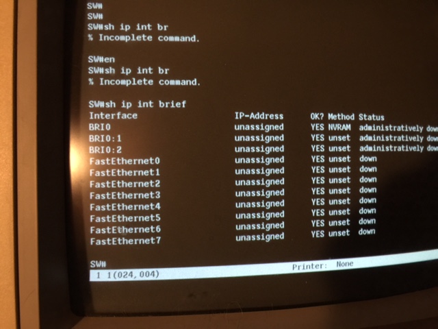

Here are the screen shots. Thanks.
The first screenshot shows that the Layer3 VLAN 10 interface has not been created. The second one shows us you have all the switchports on the correct Layer2 VLAN.
Oddly the third shows the DHCP pool we created 'dhcp_inside' but with a with a range we didn't specify.
