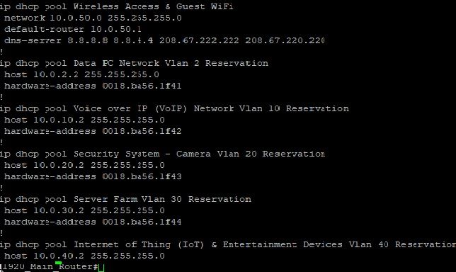

This is the current running config. which you can see that the Hardware-address is assigned a static 10.0.2.2 but it is not getting it.
Show RUNShow RUN

you config is wrong,
the interface receive the dhcp request is 10.0.50.x but the IP you want to assign is 10.0.10.x 10.0.20.x 10.0.30.x 10.0.40.x
that wrong
you need to assign static IP from same subnet 10.0.50.x
All the IP address are separate vlans. So the the IP of 10.0.2.xxx is for vlan 2 and the vlan2 on the switch should be 10.0.2.2 for each VLAN is in the respective networks.

http://www.ccieordie.com/5-3-c-dhcp-client-id-27-byte
your config is OK but the client use client-id 27 bytes that why the static IP-MAC is not wrong,
check the link above.
I found the issue with that i have to use the client id and i thought that they were all the same for the vlan except the last numbers and it is not they are different by 1 character elsewhere.
use debug ip dhcp server
then check the client-ID
in your debug
0063.6973.636f.2d30.3031.382e.6261.3536.2e31.6634.342d.566c.3330
use same client-id in your DHCP Pool,
that fast way I think
