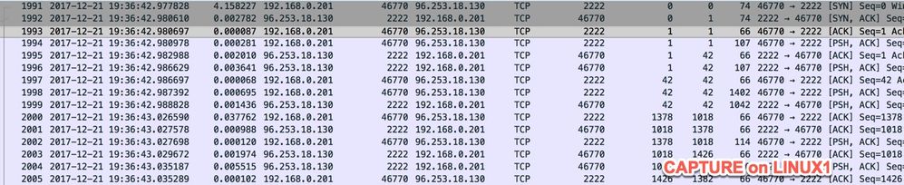

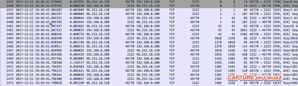

Hi
I don't want to interfere in your discussion but just wanted to be sure that I understood your issue.
From inside host when trying to access a server with its public IP it's not working, am I right?
Here is my config that works fine:
NAT-RTR#sh run | i nat
ip nat source list 100 interface GigabitEthernet0/1 overload
ip nat source static tcp 192.168.0.200 2222 96.253.18.130 2222 extendable
NAT-RTR#sh ip int bri | i 0/1
GigabitEthernet0/1 96.253.18.130 YES NVRAM up up
access-list 100 permit ip 192.168.0.0 0.0.3.255 any
NAT-RTR#sh ip nat nvi translations
Pro Source global Source local Destin local Destin global
tcp 96.253.18.130:2222 192.168.0.200:2222 --- ---
I've 2 linux machines: 192.168.0.201 (linux1) and 192.168.0.200
From linux1 when I ping linux2, it's resolved with its public IP:
srv1:~$ ping linux2
PING linux2 (96.253.18.130) 56(84) bytes of data.
64 bytes from linux2 (96.253.18.130): icmp_seq=1 ttl=255 time=1.49 ms
64 bytes from linux2 (96.253.18.130): icmp_seq=2 ttl=255 time=1.05 ms
64 bytes from linux2 (96.253.18.130): icmp_seq=3 ttl=255 time=0.985 ms
64 bytes from linux2 (96.253.18.130): icmp_seq=4 ttl=255 time=1.01 ms
64 bytes from linux2 (96.253.18.130): icmp_seq=5 ttl=255 time=1.03 ms
64 bytes from linux2 (96.253.18.130): icmp_seq=6 ttl=255 time=1.62 ms
When I do a ssh on port 2222, I get redirected correctly on my linux2 machine.
Check the tcpdump on linux1 and linux2.
Did I reproduce your exact issue? What am i missing?
Thanks
Francesco
PS: Please don't forget to rate and select as validated answer if this answered your question

OK gotcha,
Did you read my post? We are in the same situation right?
Have you done some tcp dump to check what's going on?
Thanks
Francesco
Yes I read your post and I am looking at my configuration right now.  Looks to be the exact same concept.
The configuration should work I agree, but the NAT is not allowing the traffic back in - in my case.  I included some of the debug ip nat detail above.
Did you also use a route map in your test configuration and I'm assuming the normal GE 0/1 ip nat outside and the ip nat inside for VLAN 1.
Let me change some of the rules and add the any to the access list and see what happens - I will report back in just about 1 hour.  We will get this wrapped up tonight.
OK. Just share some screenshot of tcpdump when testing
Thanks
Francesco
