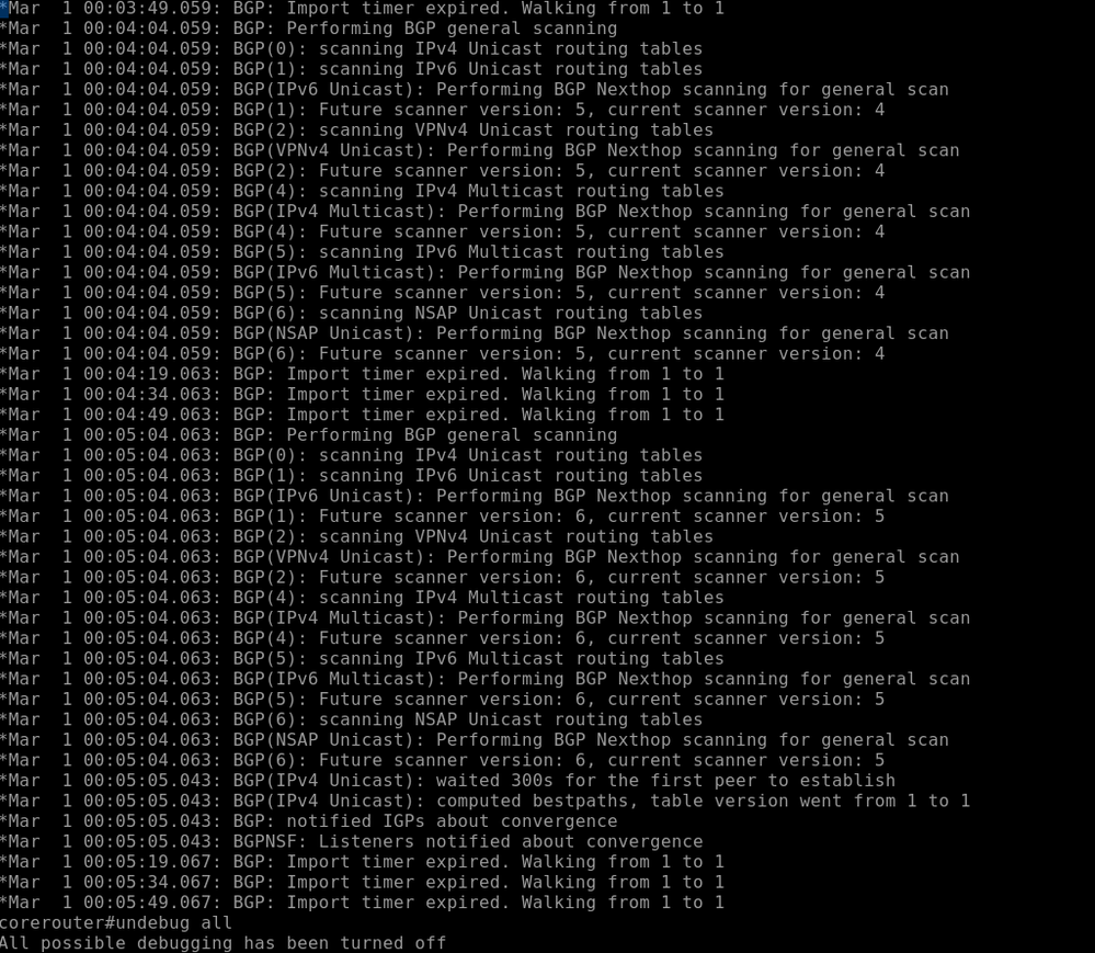

Hello @kirank10
please provide us debug ip bgp events
Thanks again.
Best regards
Hi
below is output
Mar 1 00:03:49.059: BGP: Import timer expired. Walking from 1 to 1
*Mar 1 00:04:04.059: BGP: Performing BGP general scanning
*Mar 1 00:04:04.059: BGP(0): scanning IPv4 Unicast routing tables
*Mar 1 00:04:04.059: BGP(1): scanning IPv6 Unicast routing tables
*Mar 1 00:04:04.059: BGP(IPv6 Unicast): Performing BGP Nexthop scanning for general scan
*Mar 1 00:04:04.059: BGP(1): Future scanner version: 5, current scanner version: 4
*Mar 1 00:04:04.059: BGP(2): scanning VPNv4 Unicast routing tables
*Mar 1 00:04:04.059: BGP(VPNv4 Unicast): Performing BGP Nexthop scanning for general scan
*Mar 1 00:04:04.059: BGP(2): Future scanner version: 5, current scanner version: 4
*Mar 1 00:04:04.059: BGP(4): scanning IPv4 Multicast routing tables
*Mar 1 00:04:04.059: BGP(IPv4 Multicast): Performing BGP Nexthop scanning for general scan
*Mar 1 00:04:04.059: BGP(4): Future scanner version: 5, current scanner version: 4
*Mar 1 00:04:04.059: BGP(5): scanning IPv6 Multicast routing tables
*Mar 1 00:04:04.059: BGP(IPv6 Multicast): Performing BGP Nexthop scanning for general scan
*Mar 1 00:04:04.059: BGP(5): Future scanner version: 5, current scanner version: 4
*Mar 1 00:04:04.059: BGP(6): scanning NSAP Unicast routing tables
*Mar 1 00:04:04.059: BGP(NSAP Unicast): Performing BGP Nexthop scanning for general scan
*Mar 1 00:04:04.059: BGP(6): Future scanner version: 5, current scanner version: 4
*Mar 1 00:04:19.063: BGP: Import timer expired. Walking from 1 to 1
*Mar 1 00:04:34.063: BGP: Import timer expired. Walking from 1 to 1
*Mar 1 00:04:49.063: BGP: Import timer expired. Walking from 1 to 1
*Mar 1 00:05:04.063: BGP: Performing BGP general scanning
*Mar 1 00:05:04.063: BGP(0): scanning IPv4 Unicast routing tables
*Mar 1 00:05:04.063: BGP(1): scanning IPv6 Unicast routing tables
*Mar 1 00:05:04.063: BGP(IPv6 Unicast): Performing BGP Nexthop scanning for general scan
*Mar 1 00:05:04.063: BGP(1): Future scanner version: 6, current scanner version: 5
*Mar 1 00:05:04.063: BGP(2): scanning VPNv4 Unicast routing tables
*Mar 1 00:05:04.063: BGP(VPNv4 Unicast): Performing BGP Nexthop scanning for general scan
*Mar 1 00:05:04.063: BGP(2): Future scanner version: 6, current scanner version: 5
*Mar 1 00:05:04.063: BGP(4): scanning IPv4 Multicast routing tables
*Mar 1 00:05:04.063: BGP(IPv4 Multicast): Performing BGP Nexthop scanning for general scan
*Mar 1 00:05:04.063: BGP(4): Future scanner version: 6, current scanner version: 5
*Mar 1 00:05:04.063: BGP(5): scanning IPv6 Multicast routing tables
*Mar 1 00:05:04.063: BGP(IPv6 Multicast): Performing BGP Nexthop scanning for general scan
*Mar 1 00:05:04.063: BGP(5): Future scanner version: 6, current scanner version: 5
*Mar 1 00:05:04.063: BGP(6): scanning NSAP Unicast routing tables
*Mar 1 00:05:04.063: BGP(NSAP Unicast): Performing BGP Nexthop scanning for general scan
*Mar 1 00:05:04.063: BGP(6): Future scanner version: 6, current scanner version: 5
*Mar 1 00:05:05.043: BGP(IPv4 Unicast): waited 300s for the first peer to establish
*Mar 1 00:05:05.043: BGP(IPv4 Unicast): computed bestpaths, table version went from 1 to 1
*Mar 1 00:05:05.043: BGP: notified IGPs about convergence
*Mar 1 00:05:05.043: BGPNSF: Listeners notified about convergence
*Mar 1 00:05:19.067: BGP: Import timer expired. Walking from 1 to 1
*Mar 1 00:05:34.067: BGP: Import timer expired. Walking from 1 to 1
*Mar 1 00:05:49.067: BGP: Import timer expired. Walking from 1 to 1DEBUG BGP.PNG
