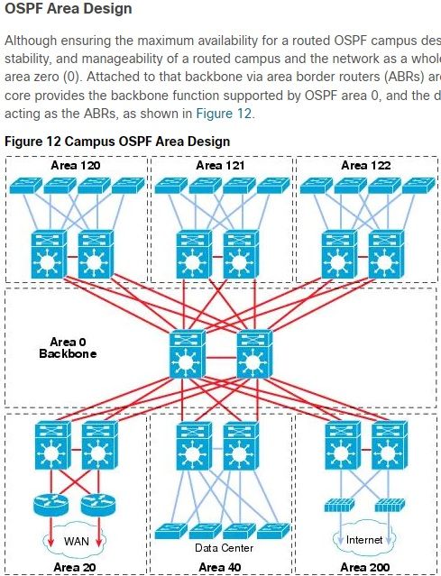

Good reference.
BTW, if you look at that reference's OSPF Area Design you might note how the data center (area 40) is not included in area zero, or the campus backbone.  This might appear to make what Rick suggested, keeping your DC in area zero, somehow "wrong", but he is not.  Again, you can migrate DC routers into their own area (yea, perhaps some extra work), but I suspect Rick might also have in mind that your overall network being so small, having the DC within area zero, isn't really bad because logically, the DC is the core of all your services.
So as Rick also noted in his recent reply, there's much detail we don't know, making it difficult to chose an approach, and even if we did have much more detailed knowledge, often much of network design is, as Rick also notes, a matter of opinion, often without really one being "right" vs. the other being "wrong".

I did see your earlier posting.
Firstly, what I thought my reference linked to was inside of your document reference, which should be (?)
In the above, "Data Center" appears to be in "Area 40".
The point of my prior posting was, this diagram, having DC in its own area, seems contrary to what Rick was recommending, i.e. using area zero for a one area topology, at at least initially, keeping DC routers in it.  Although, in fact, this diagram is contrary, I tried to say, what Rick recommended wasn't "wrong", like he notes, there's much we don't know about OP's network, and future plans, and there are possible reasons why to keep DC routers in area zero contrary to this diagram.
My posting, didn't intend to be relevant to any of yours, and it it appears contrary to such, I didn't realize it was.  That said, briefly scanning that whole document, I couldn't find "area 40 in doc. is for AGGR-ACCESS not AGGR-CORE. ", where's that at?
