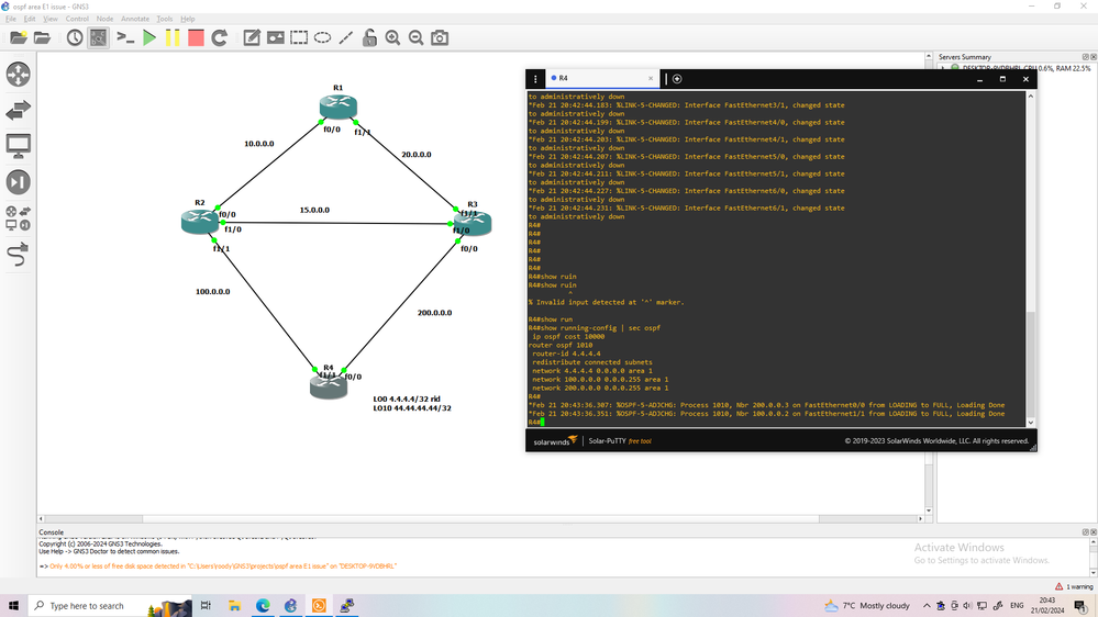

I run lab and I success
1-first make the interconnect between the ABR1 and ABR2 in area 1
2- config LO user as Router ID in R4 (leaf) and advertsie this LO with
network
command not via redistribute,
this LO is additional to LO we will redistribute as E1
why these two steps
first LO RID will advertise as LSA1 to ABR1 via direct and via interconnect link between the ABR1and2
the LO E1 will know learn with forward address 0.0.0.0 so the abr1 will use RID to forward to select path, the LO RID which is LSA1 have two path one via 10000 (in my lab I config cost 10000) and other lower than interconnect ABR1and2
so the ABR1 will select path for LO E1 via short path toward LO RID
and that we you want
thanks
MHM
network
why these two steps
thanks
MHM
