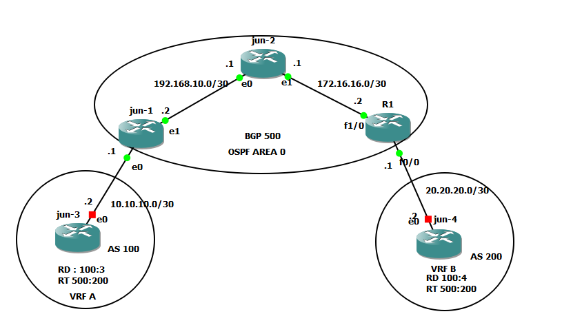

MPLS Layer 3 VPN not working b/w Juniper and cisco
Hii
i create topology with juniper and cisco .
VPNv4 established b/w PE's
Client get routes from each other But unable to reach or ping ,
if anybody help me to s
Hello @Gagandeep_Singh_1997 ,
your juniper devices configuration look like incomplete.
However, to be able to ping from a CE connected to a LAN interface you need table vrf under appropriate context.
[edit routing-instances routing-instance]
user@host# set instance-type vrf
user@host# set interface interface-name
user@host# set route-distinguisher route-distinguisher-id
user@host# set provider-tunnel rsvp-te static-lsp vpn1-p2mp
user@host# set vrf-target vrf-target-community
user@host# set vrf-table-label
see
https://www.juniper.net/documentation/us/en/software/junos/vpn-l3/topics/topic-map/l3-vpns-routes-vrf-tables.html
I remember my fist tests with Juniper routers I had this issue.
The command sets a single MPLS label for all the VRF prefixes and it is required by Junos to be able to perform a second lookup.
Hope to help
Giuseppe

Thanks sir , i miss following command in juniper PE
set vrf-table-label
